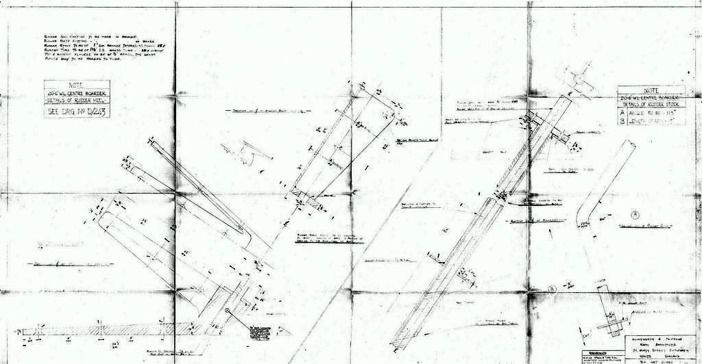

Re: stern gland rudder details
Postby bearmcnally » Tue Oct 25, 2011 2:58 pm
Hi Guys
hope this helps your discussion
