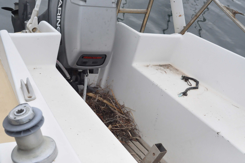

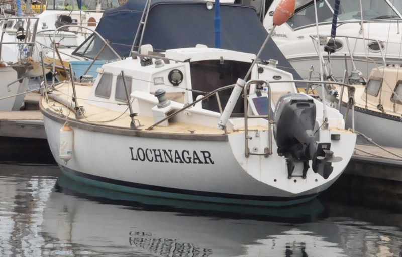

Postby surrealbass » Fri Dec 17, 2010 11:21 pm
as you can see she is not looked after- mast has been out of her for quite a while
here is another example, this is a cold moulded Tophat a couple of rows over from me
Chris
