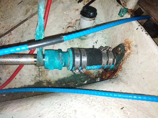

Another battery leads goes from your anode bolt to a woven battery lead that is spring/rubber loaded around your prop shaft to protect your prop, see photo.
And that should do it. Happy New Year!
