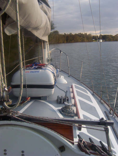

Speaking of life rafts, does anyone actually have one on their top hat?
They are bulky and heavy, there aren't many places to fit one...

It maybe possible to lash a liferaft to the taffrail, or Phil on Seaka has made a board the joins each side of the rear of the cockpit seats, he has carried an inflatable dinghy there, or store it below, so theres a few possible spots.
